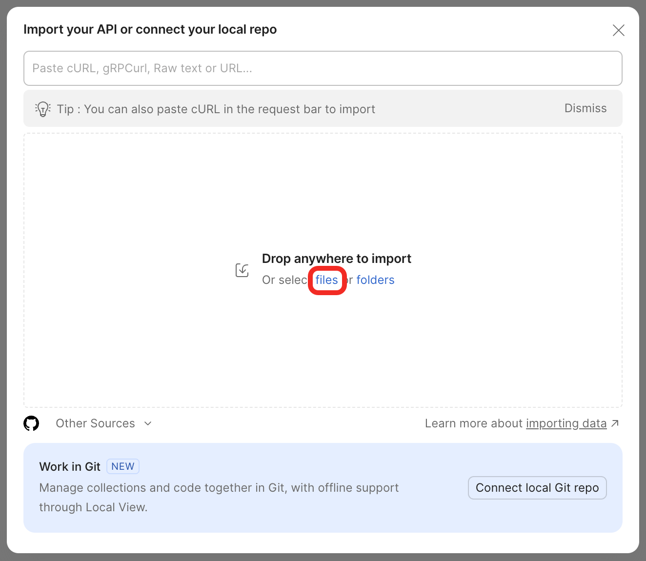

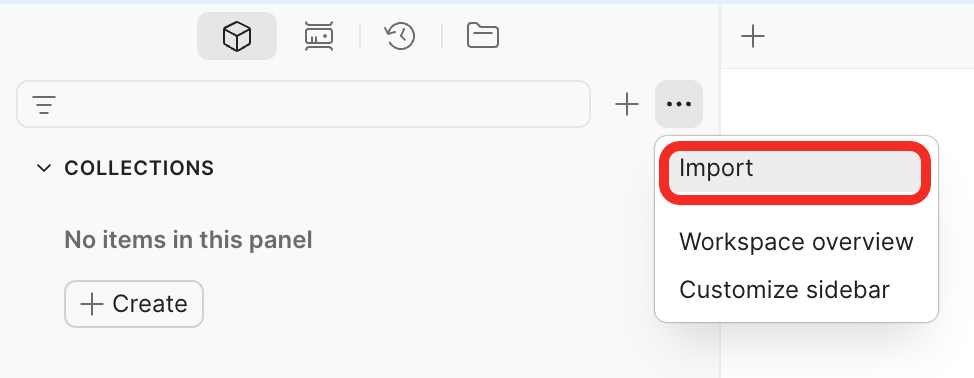

  1. Open Postman, and click ... > Import in the left sidebar.
    Click Import
  2. Upload the extracted data-export-api.yaml file to the popup.
    Upload file

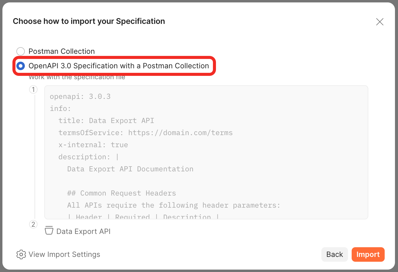

  3. In the popup, select OpenAPI 3.0 with a Postman Collection, and click the Import button.
    Select OpenAPI 3.0 with a Postman Collection

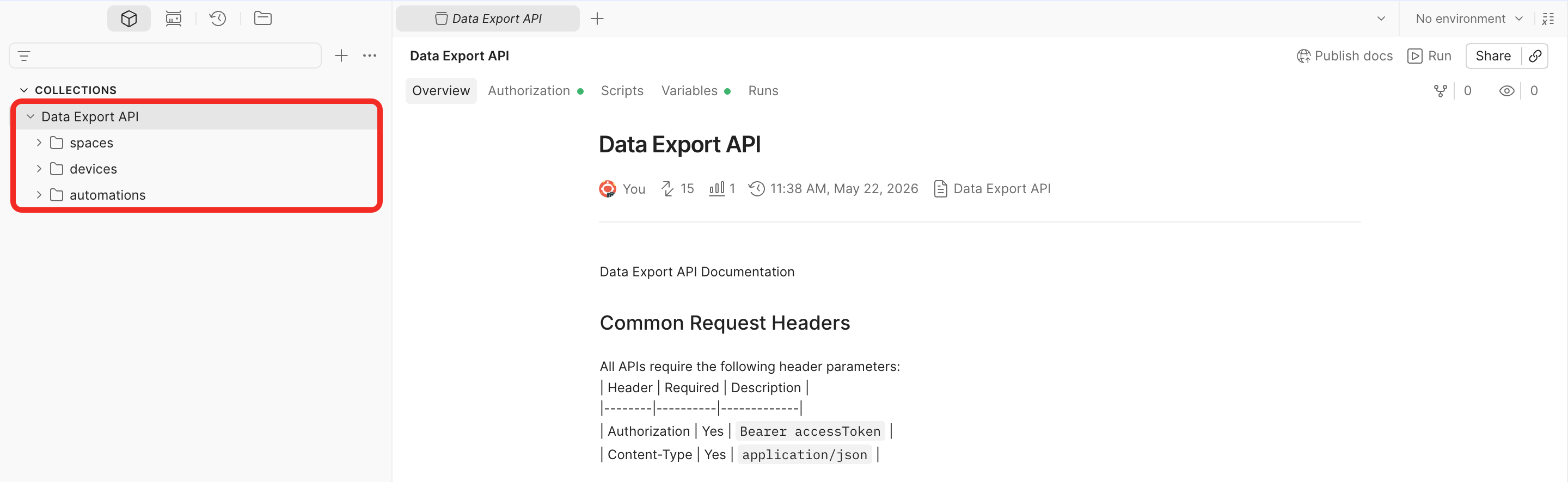

  4. After a successful import, you will see the Data Export API collection in the sidebar.
    Import successful

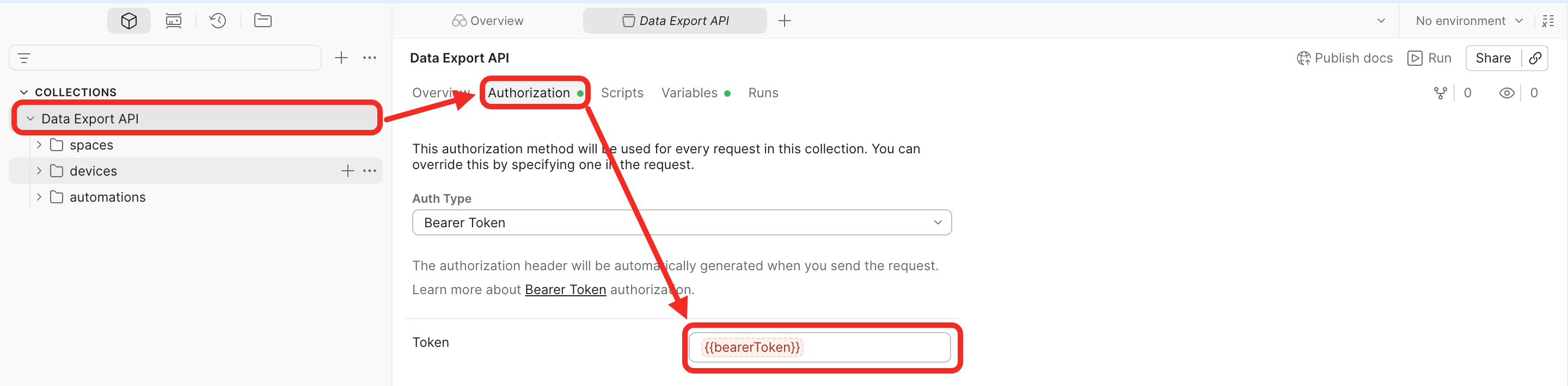

  1. In the left sidebar, click Data Export API, switch to the Authorization tab, and input the Token you have obtained from Aqara Studio.
    Set Token
    tip
    Please make sure the Type is set to Bearer Token. If not, select Bearer Token from the dropdown menu.

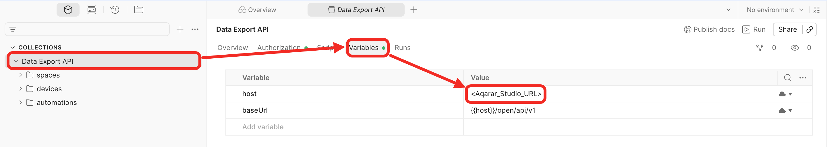

  2. Switch to the Variables tab, and enter your Aqara Studio service address under the host field. Both local LAN IP (http) and remote addresses (https) are supported.
    Set host address

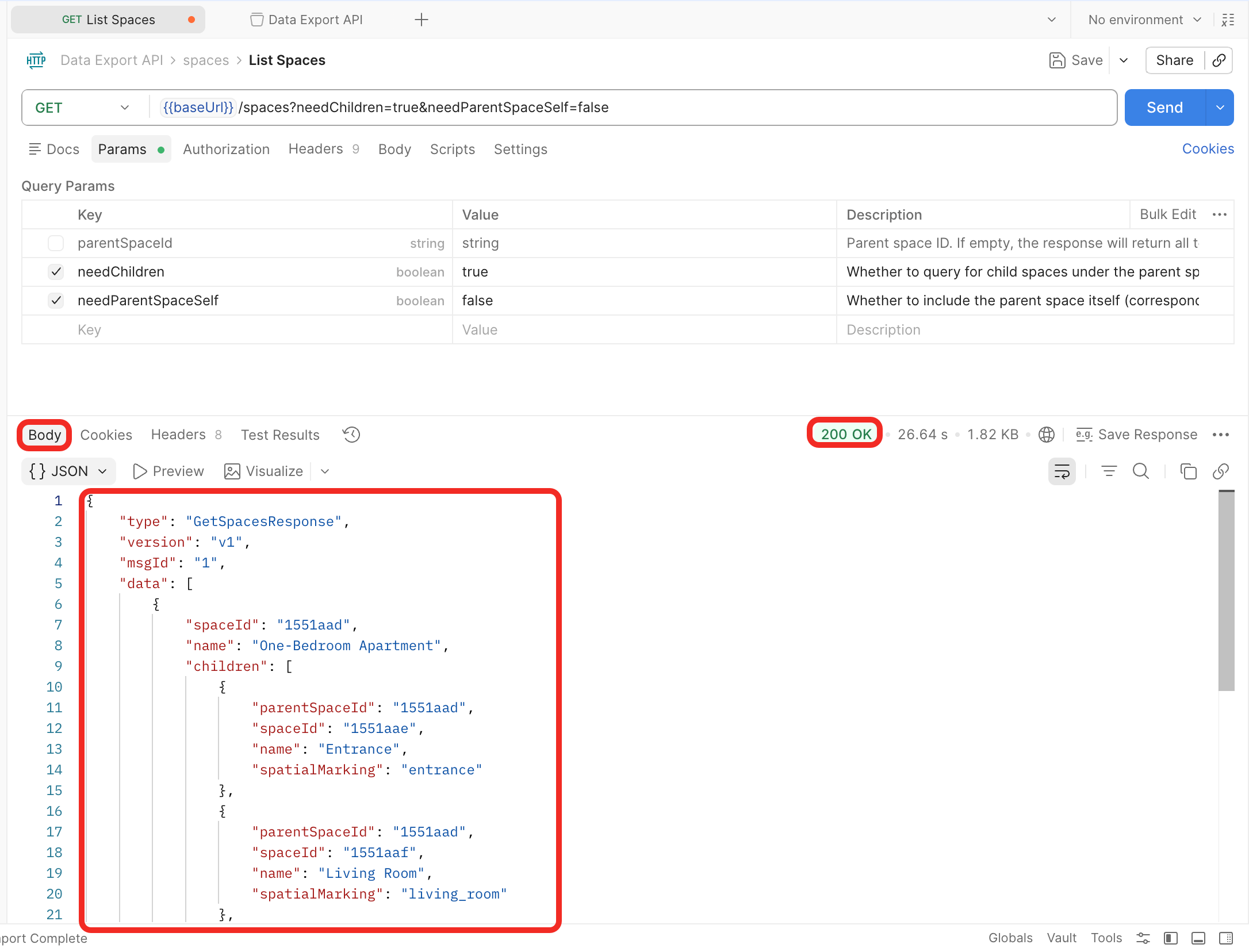

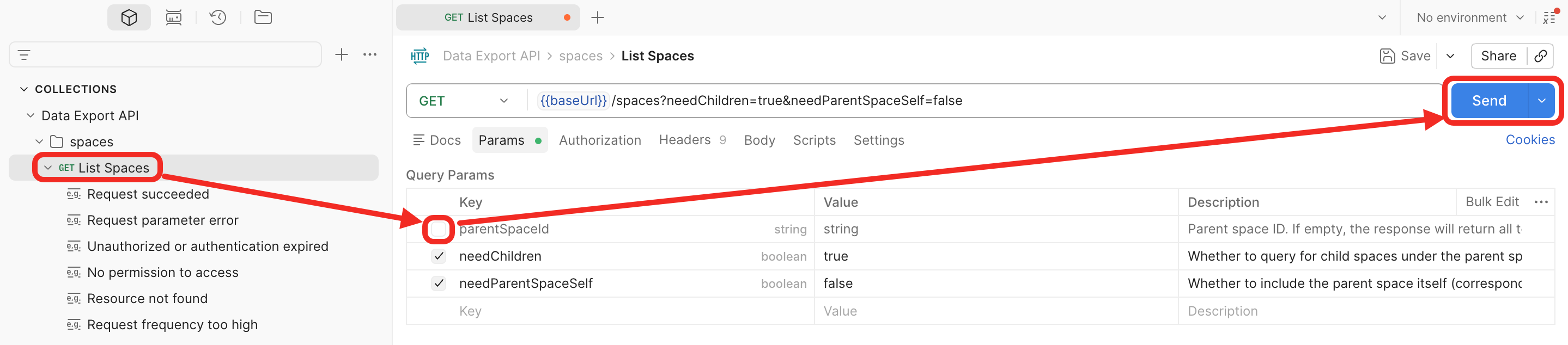

  1. In the Postman sidebar, select Data Export API > spaces > List Spaces. Uncheck parentSpaceId, no need to configure the request Body, then click the Send button to fetch the complete list of spaces.
    List Spaces

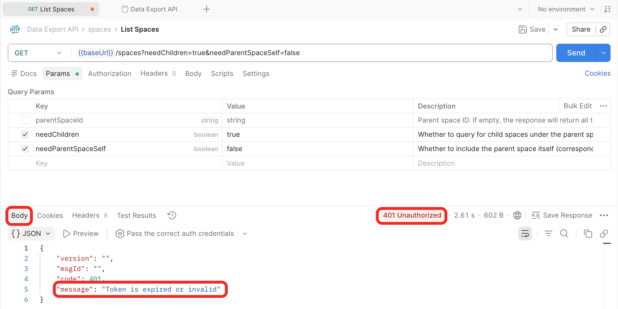

  2. In the Body section below, confirm that the HTTP status code is 200, which indicates the request was successful.
    • If yes: Check whether the code field is 0.
      • 0: The list was retrieved successfully, and you can view the space list in the JSON response.
      • Not 0: Indicates failure; please check the message in the response for troubleshooting.
      List Spaces response
    • If no: The request failed; check the message in the response for troubleshooting.
      Request failed example

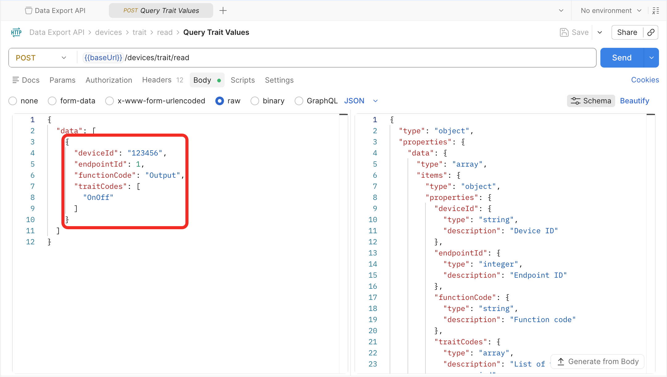

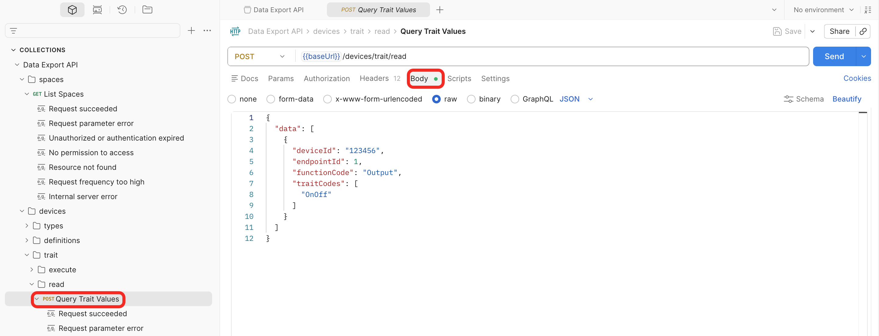

  1. In the Postman sidebar, select Data Export API > devices > traits > read > Query Trait Values, then click Body.
    Query Trait Values API

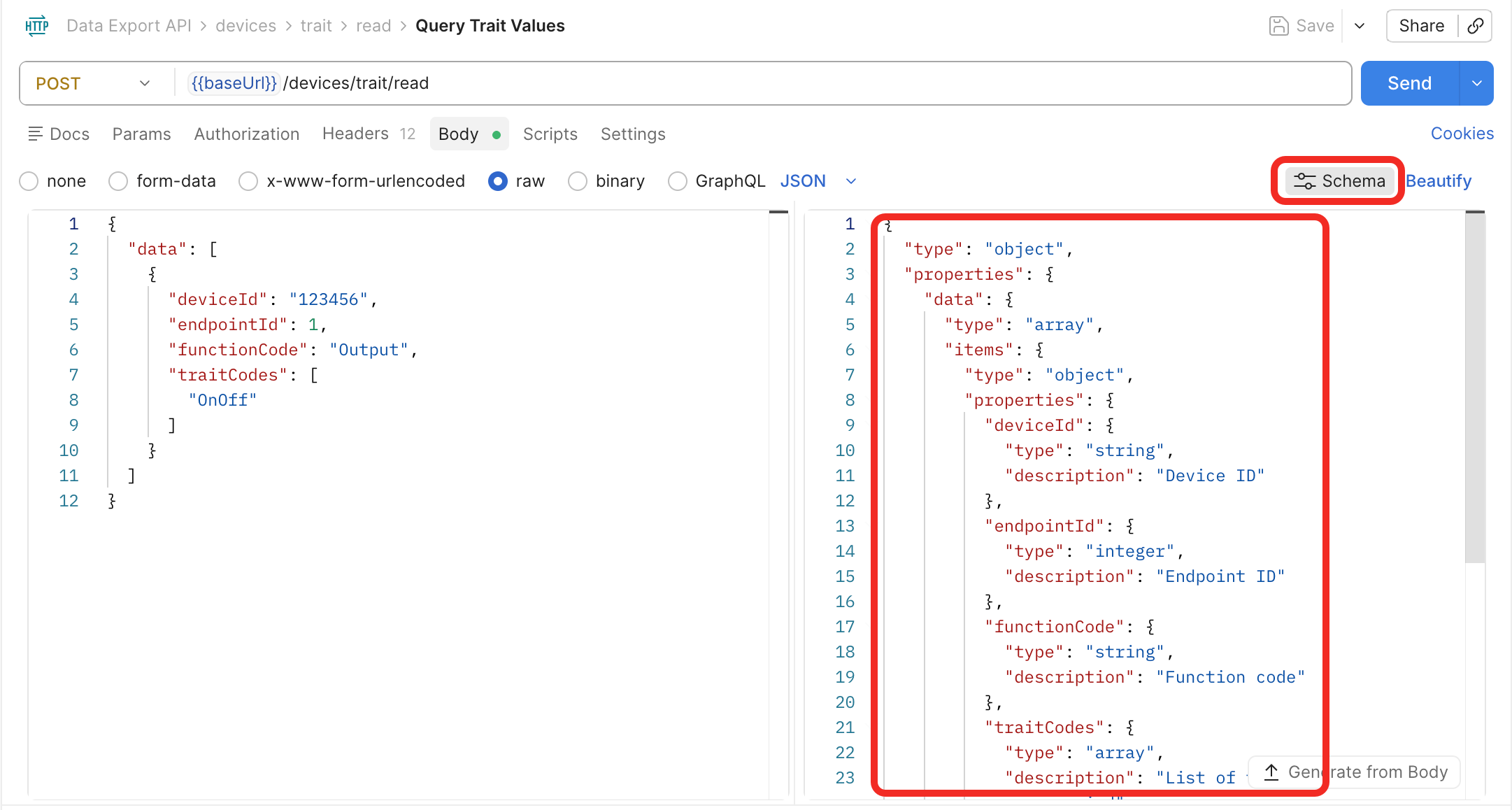

  2. Since this is a POST request, click Schema to view the description of the Body fields.
    Read Schema
  3. In the data object, fill in the device ID, endpoint ID, function code, and the list of trait codes to query. Then click the Send button to request the Trait values.
    Configure request Body
  4. Similar to the List Spaces API, check the HTTP status code in the Body section below. If it is 200, the request was successful.
