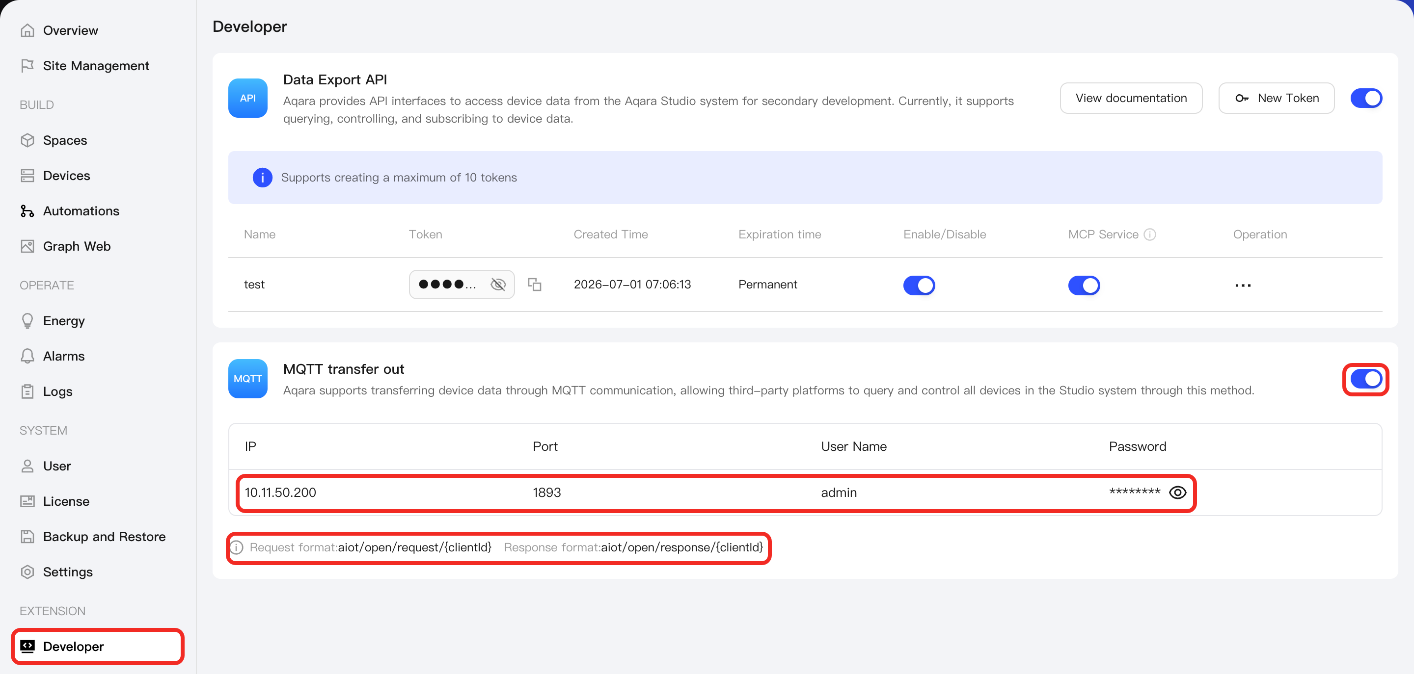

  1. In the left sidebar of Aqara Studio, go to Developer and enable the MQTT transfer out service.
    You will then see all the information needed to connect to MQTT (such as local IP, MQTT port, username, password), as well as the formats for request and response topics.
    Get MQTT connection info
