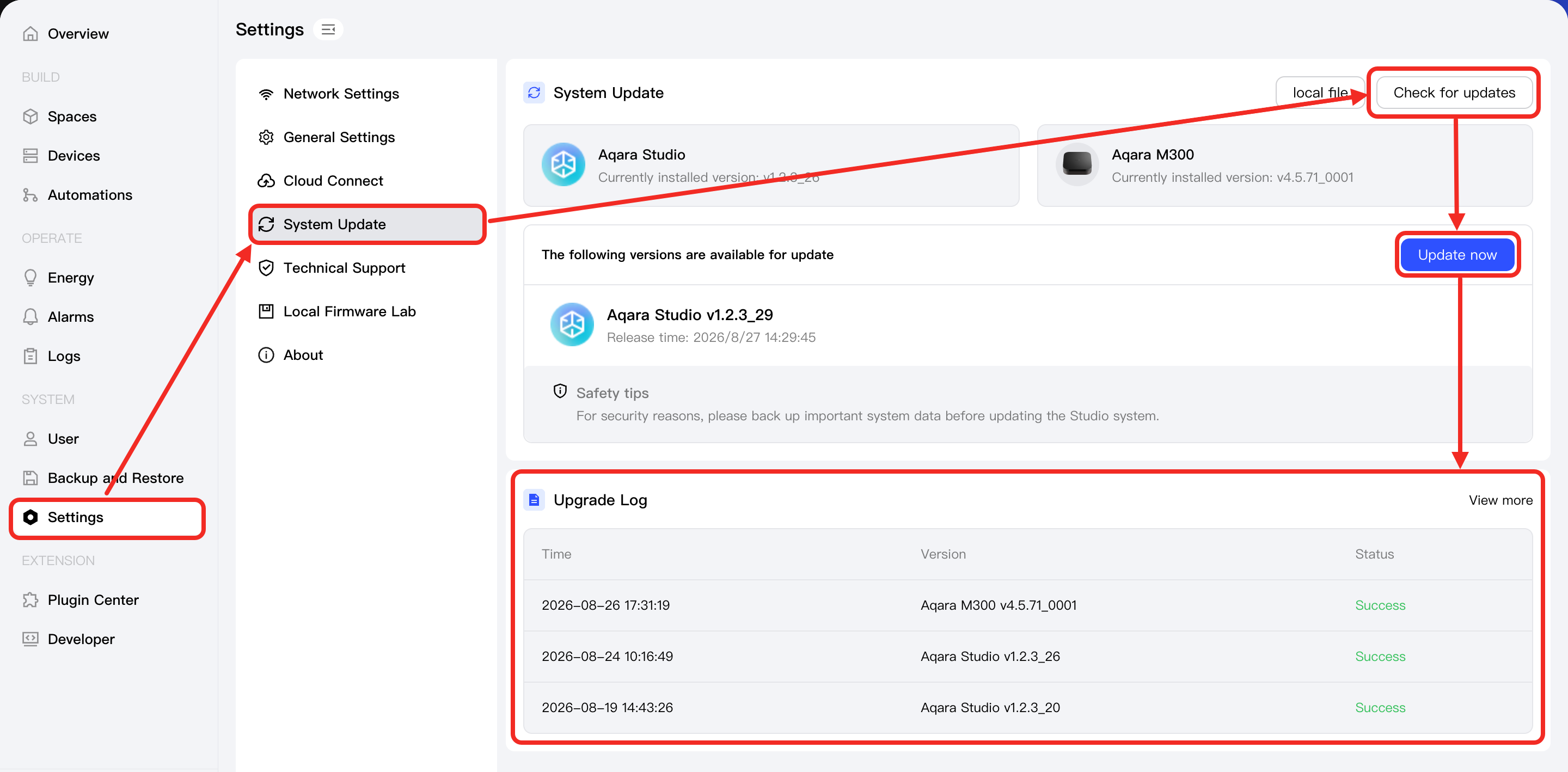

  1. In the left navigation bar, go to Settings > System Update. You can see the current version number of Aqara Studio and the firmware version of the Aqara Gateway (only for the hub-integrated version of Aqara Studio).
  2. Click the Check for updates button. The system will automatically check if any new version is available. If a new version is detected, you can read its description and decide whether to update.
  3. Click the Update Now button to start the update.
    tip
    • For security reasons, please back up important data before updating Aqara Studio.
    • For the hub-integrated version, the system will upgrade the Aqara Gateway firmware first, then update the Aqara Studio version.
  4. After the update is completed, the system will automatically log you out.
  5. Please log in to Aqara Studio again, go to the System Update page, and check the Update Log to confirm whether the update was successful.
