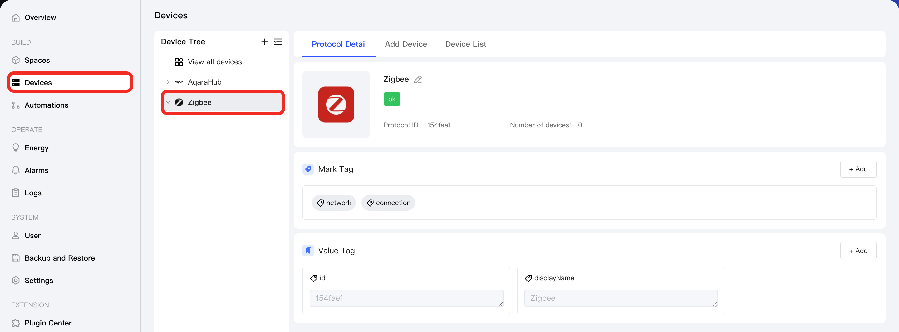

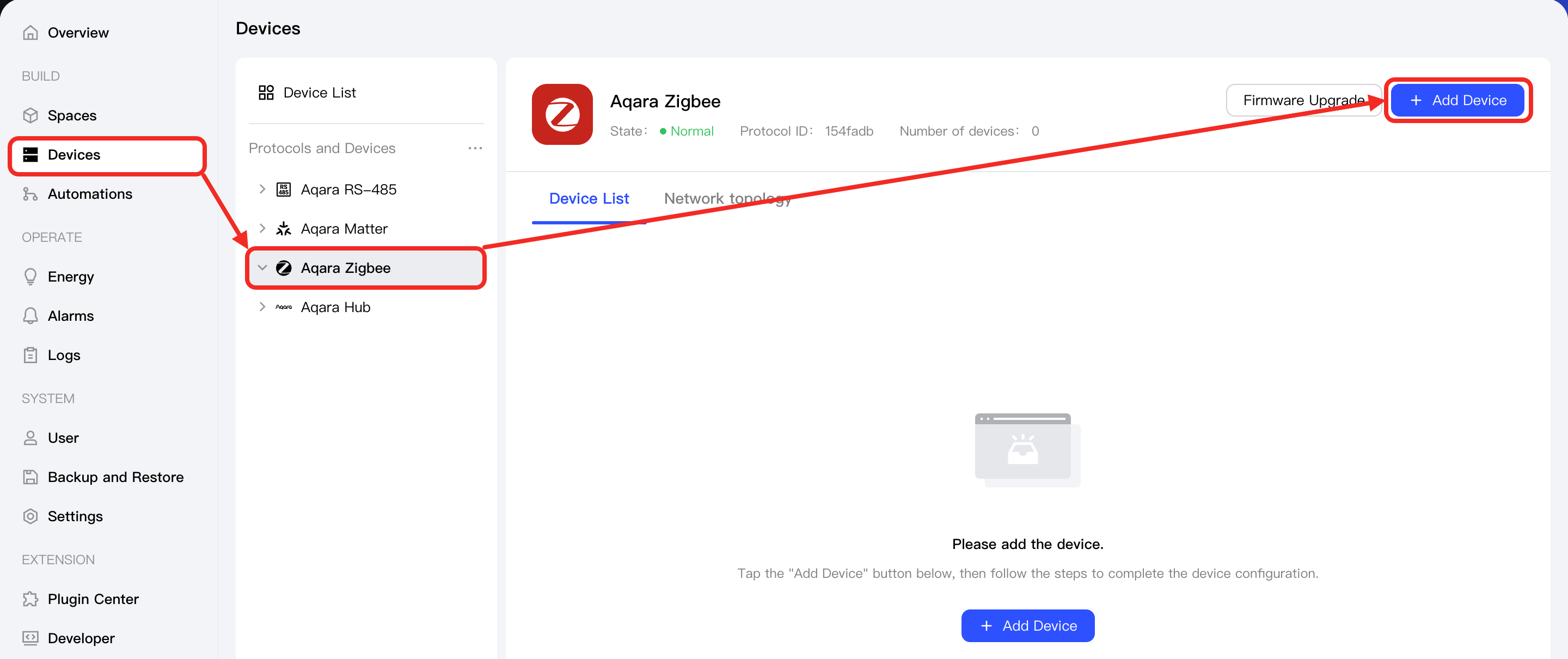

  1. In the left sidebar, click to enter the Devices page. Select Zigbee to open the management page.
    Select Zigbee

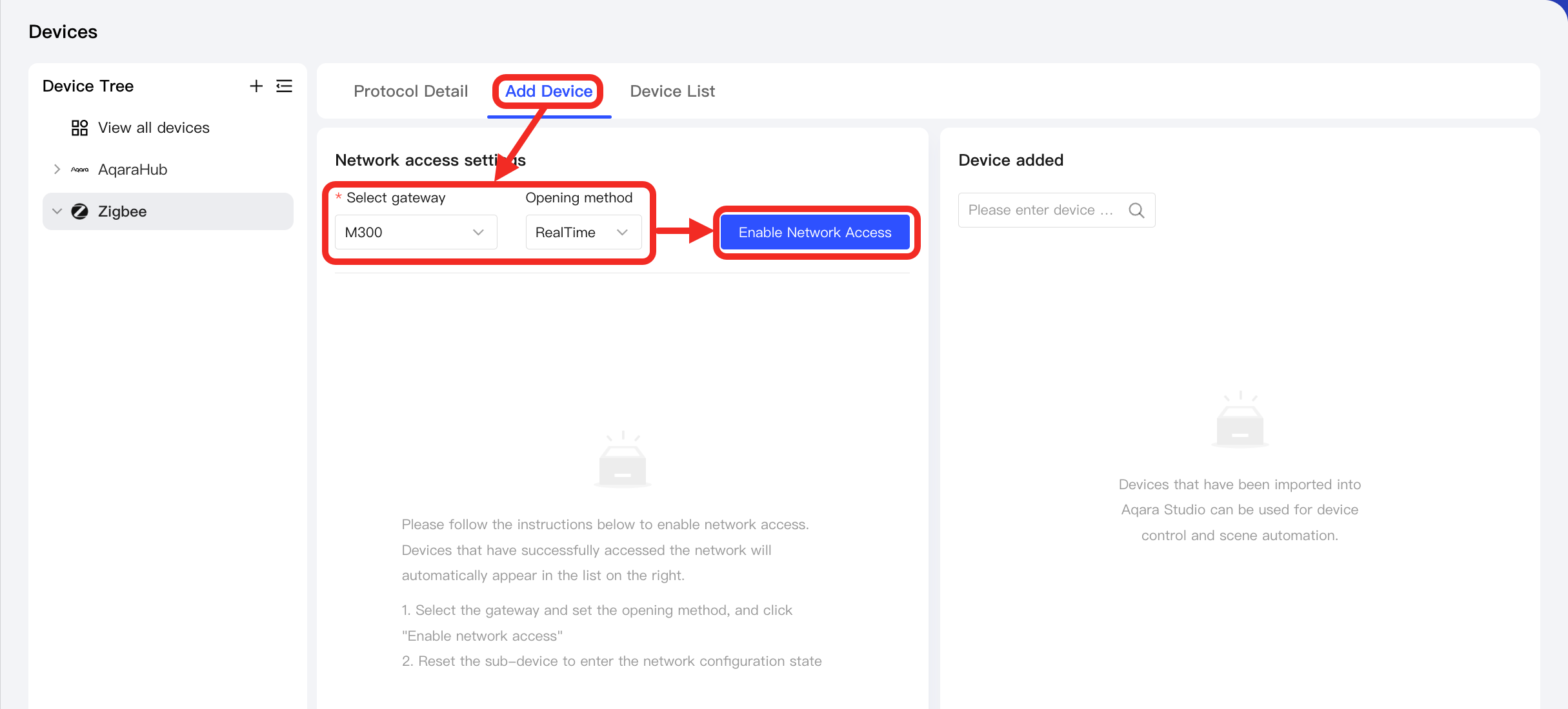

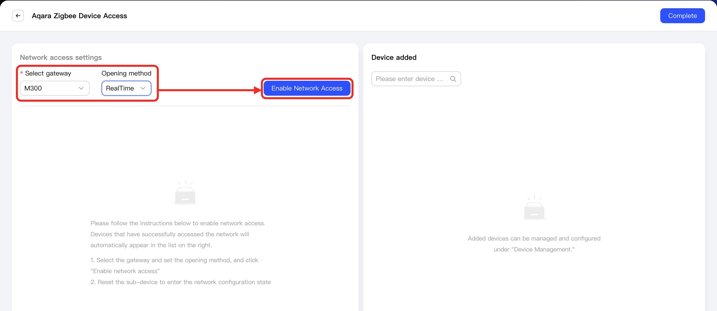

  2. Go to the Add Device tab. In the Select gateway dropdown, select the gateway to which you want to bind sub-devices. Under Opening method, choose the pairing mode for the gateway (supports Tealtime or Timing).
    Click the Enable Network Access button. The selected gateway will enter pairing mode. Now put the sub-device into pairing mode to complete the binding.
    Configuration
  3. Once the sub-device is successfully bound, it will appear in the Device added list.
