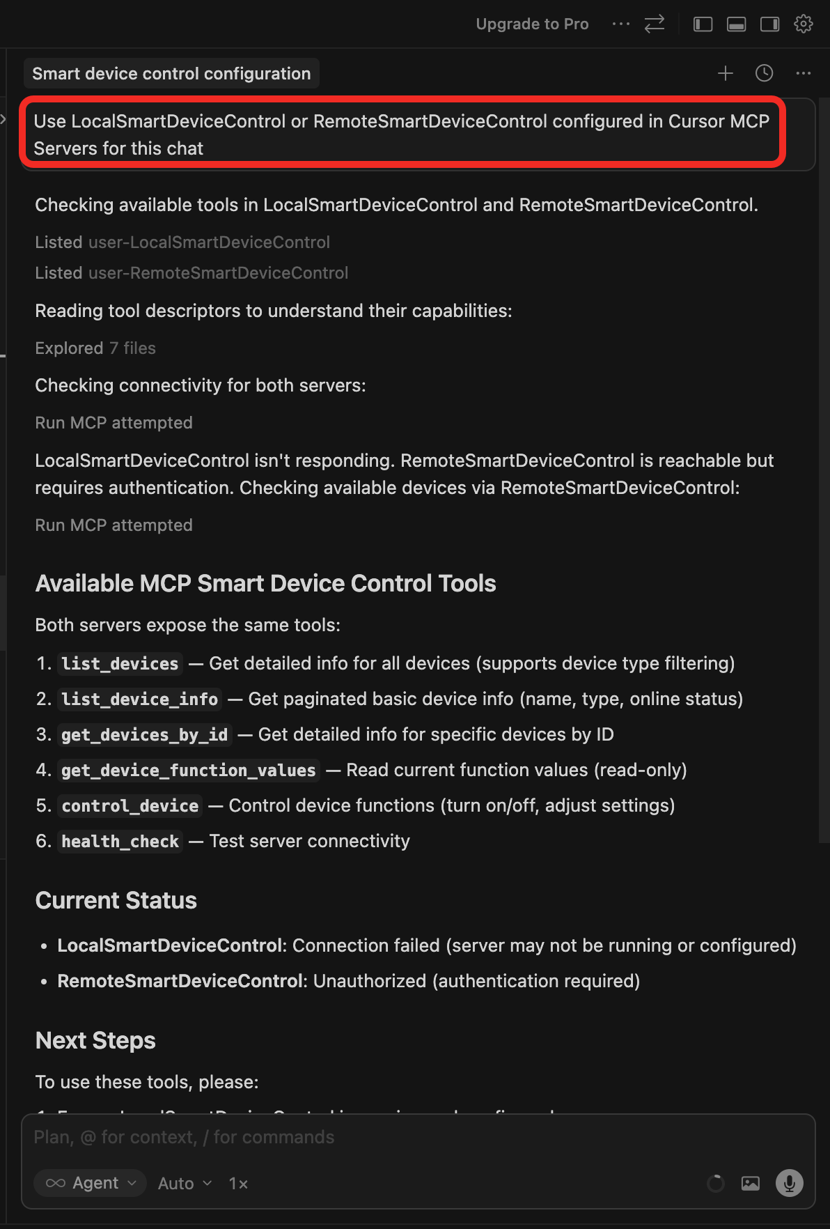

  4. In the Cursor chat, type a command like:
    • Use LocalSmartDeviceControl or RemoteSmartDeviceControl configured in Cursor MCP Servers for this chat
    • Use LocalSmartDeviceControl or RemoteSmartDeviceControl from Tools & MCP
    • Or some similar text asking Cursor to use one of your configured MCP servers.
    tip
    If Cursor says it does't detect an MCP, you can type already configured again in the chat and wait for MCP setup confirmation.

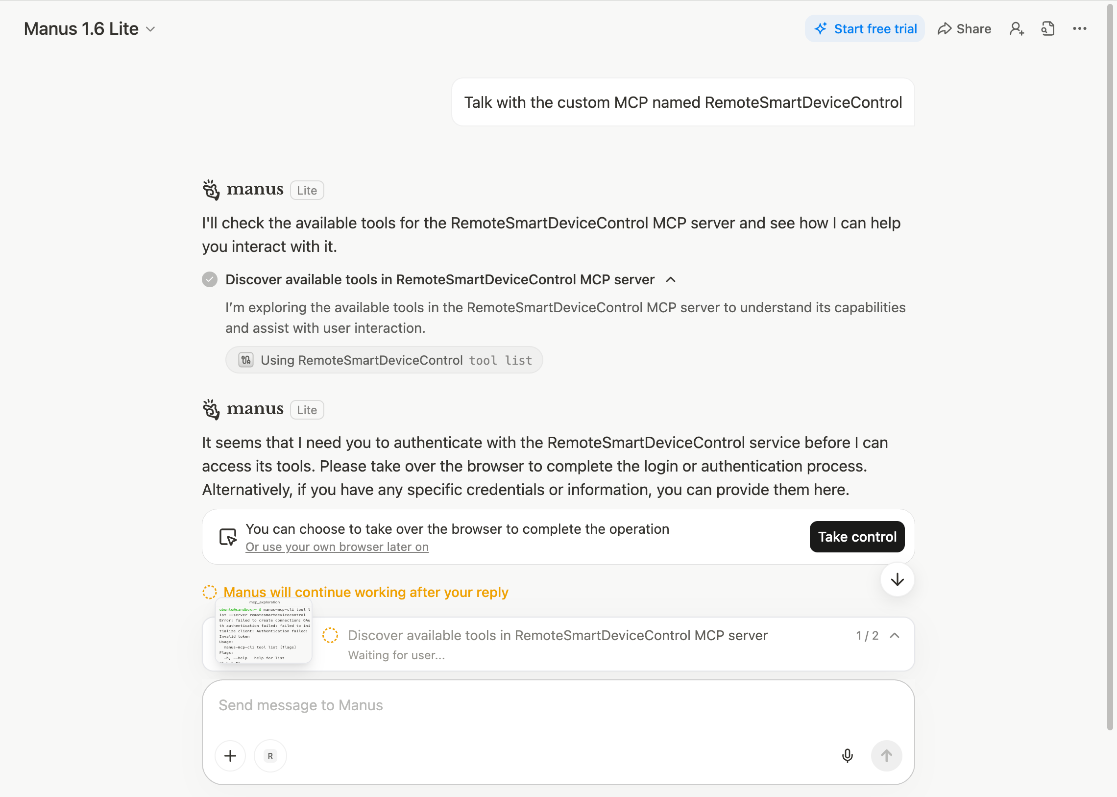

  5. In the chat window, enter: Talk with the custom MCP named RemoteSmartDeviceControl.
    You can also use similar commands to trigger the service.
    Start using

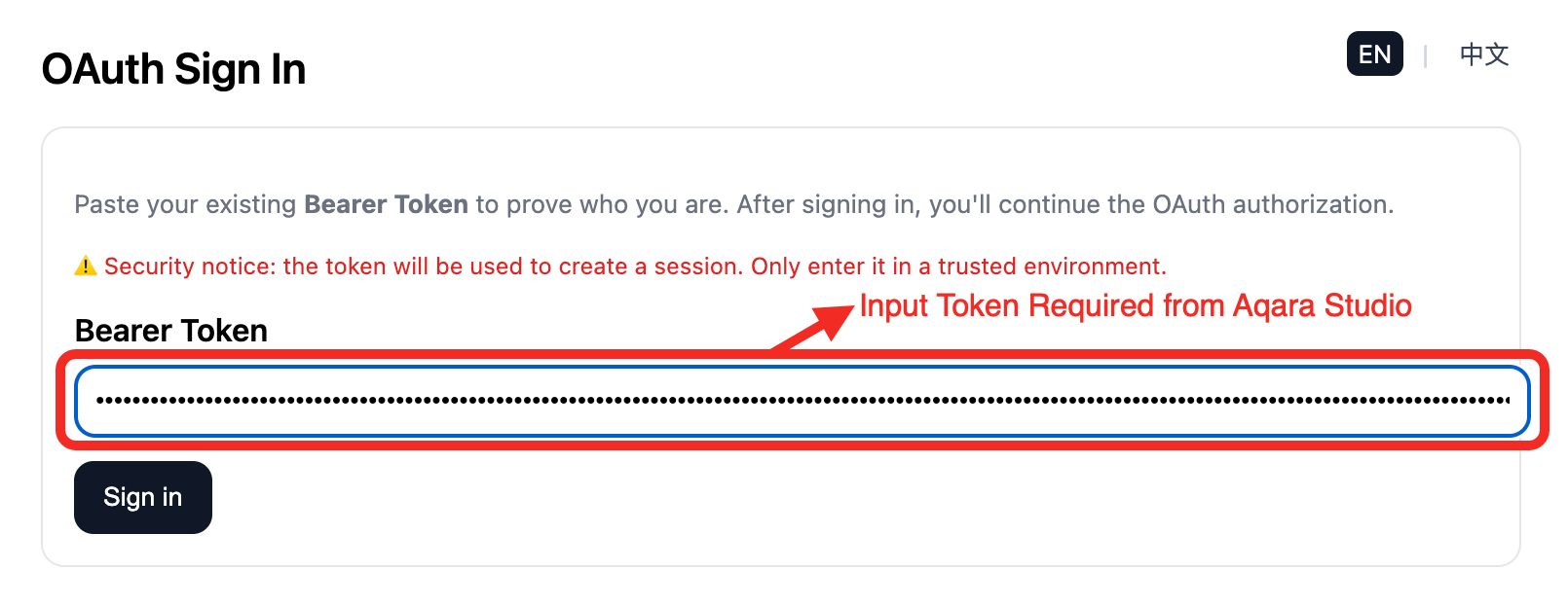

  4. On the OAuth Sign In page, enter your token.
    Fill in token

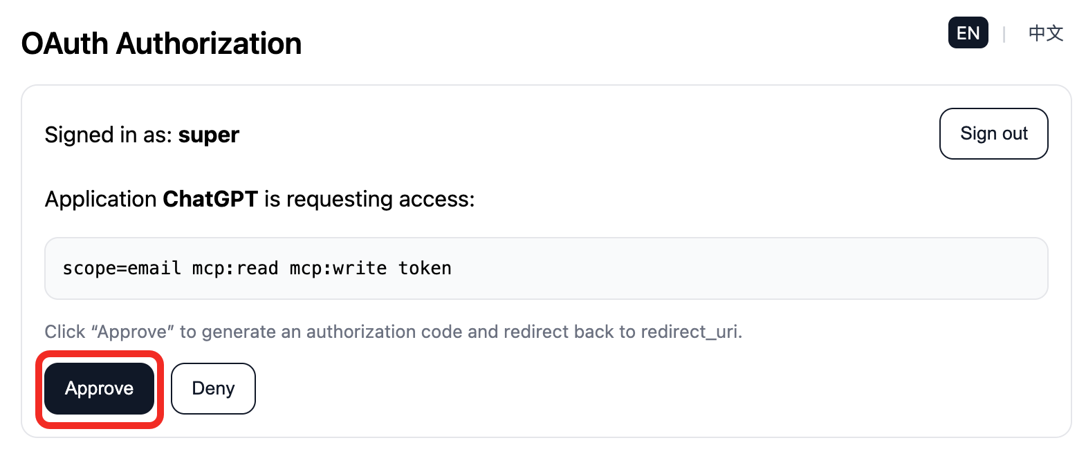

  5. On the OAuth Authorization page, click Approve to activate your MCP app.
    Approve OAuth
