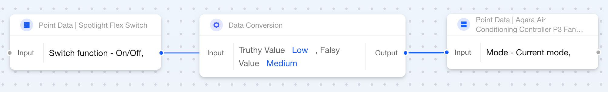

Boolean to Enumeration
To convert from a boolean value to an enumeration value, you need to set the mapping rule in the Data Conversion block:
- Truthy Value: Select the target enumeration value when the input is
true. - Falsy Value: Select the target enumeration value when the input is
false.

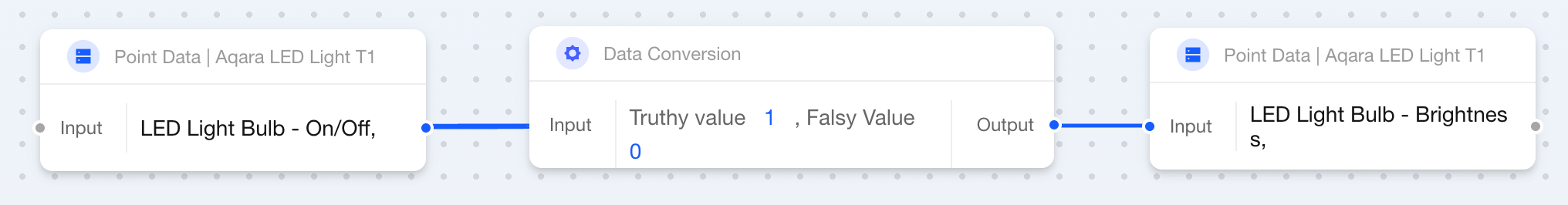

Boolean to Number
To convert from a boolean value to a number, you need to set the mapping rule in the Data Conversion block:
- Truthy Value: Set the target number when the input is
true. - Falsy Value: Select the target number when the input is
false.

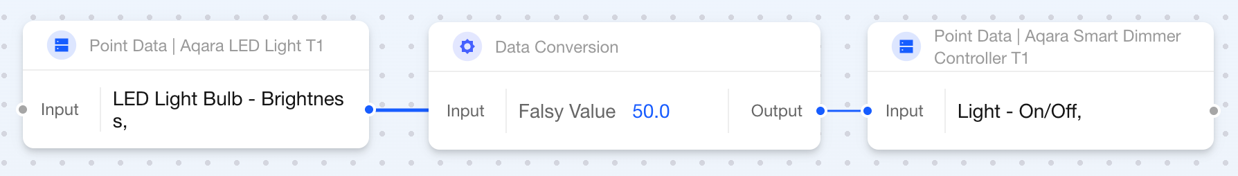

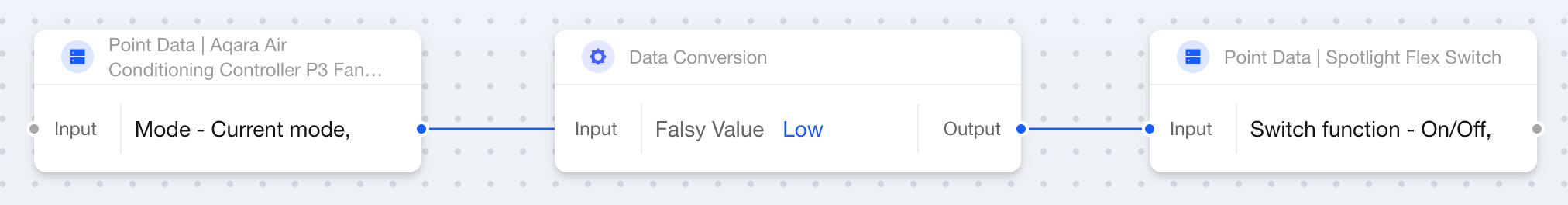

Enumeration to Boolean
You need to specify an enumeration value as false to complete the conversion:
- Falsy Value: If the input enumeration value matches the configured value, the output is
false. Otherwise, the output istrue.

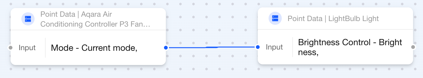

Enumeration to Number
When an enumeration block is connected to a number block, the number block directly obtains the numerical value of the input enumeration. For example, an enumeration value with index 0 corresponds to the number 0.

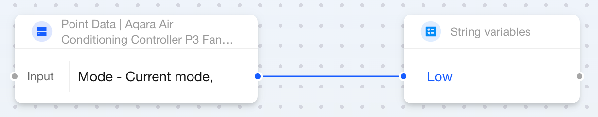

Enumeration to String
When an enumeration block is connected to a string block, the string block directly obtains the name of the input enumeration value. As shown in the figure, the string variable directly displays the device's current mode, which is "Low".

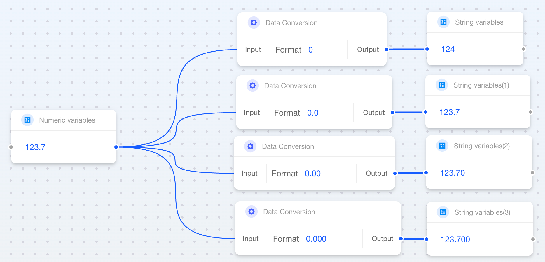

Basic Number
| Format | Description | Number (Before) | String (After) |
0 | Integer | 123.7 | 124 |
0.0 | One decimal place | 123.7 | 123.7 |
0.00 | Two decimal places | 123.7 | 123.70 |
0.000 | Three decimal places | 123.7 | 123.700 |

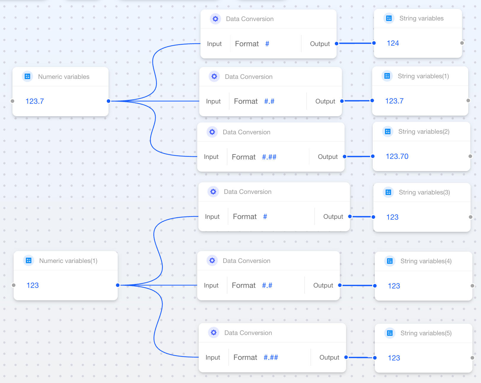

Flexible Decimal Places
# | Rounds to integer (no zero padding) | 123.7 | 124 |
#.# | Formats with up to 1 decimal | 123.7 | 123.7 |
| 123.0 | 123 | ||
#.## | Formats with up to 2 decimals | 123.7 | 123.7 |
| 123.00 | 123 |

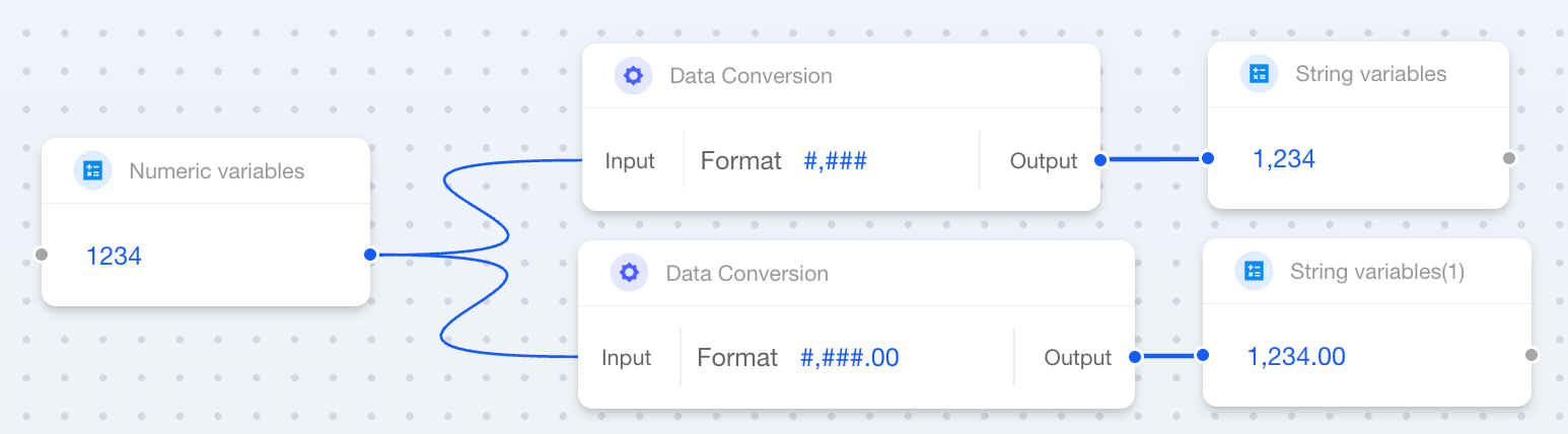

Thousands Separator
#,### | Thousands separator | 1234 | 1,234 |
#,###.00 | Thousands separator + 2 decimals | 1234.5 | 1,234.50 |

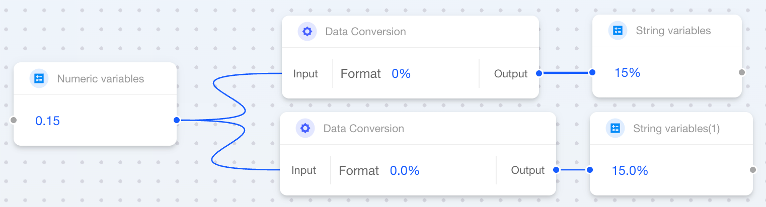

Percentage
0% | Percentage | 0.15 | 15% |
0.0% | One decimal percentage | 0.15 | 15.0% |

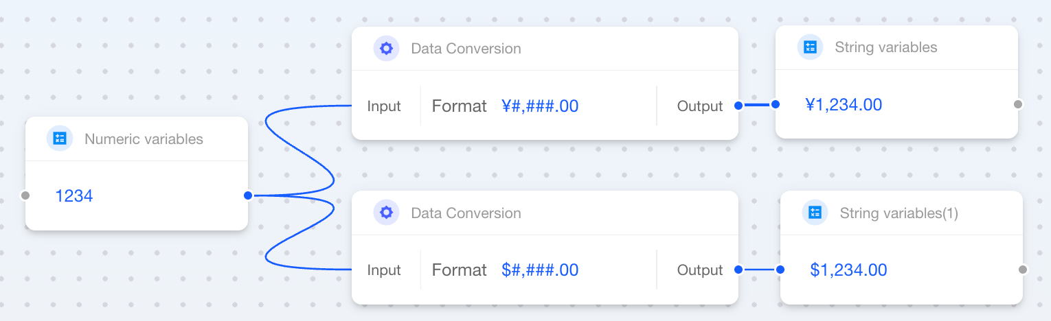

Currency Format
¥#,###.00 | Chinese Yuan format | 1234.5 | ¥1,234.50 |
$#,###.00 | US Dollar format | 1234.5 | $1,234.50 |
