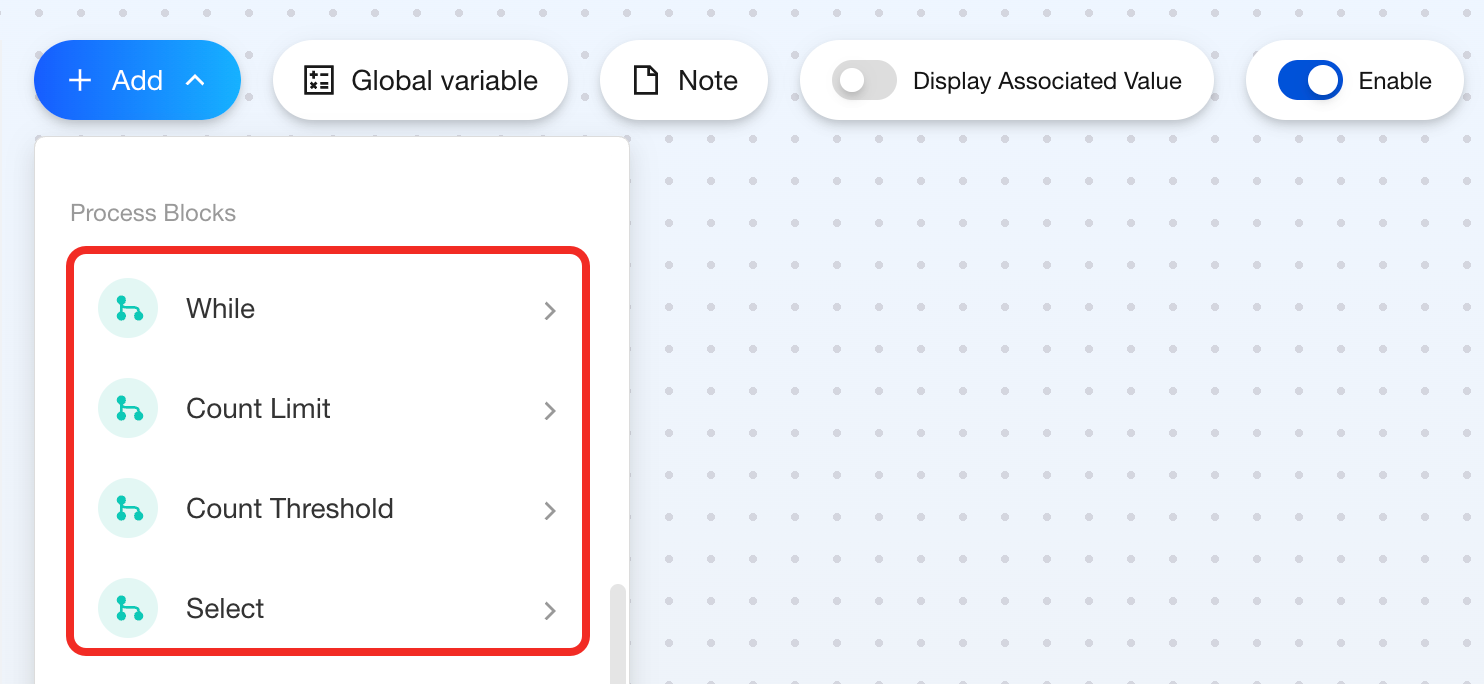

The Process category includes the following blocks:
Total process blocks

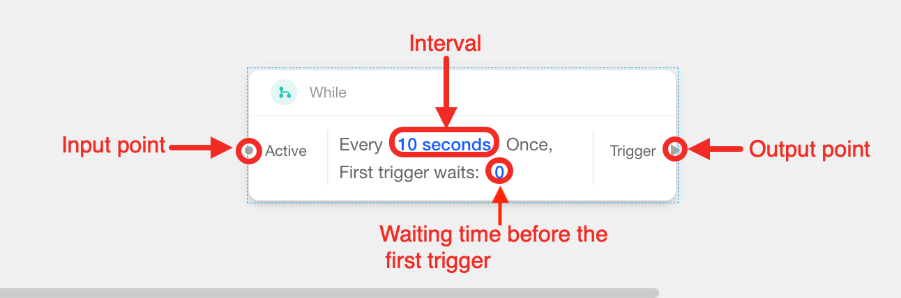

This block is dual-point type, with 1 input point, 1 output point and 1 parameter:
Connection point / ParameterRequiredDescription
Active (input)It controls when the loop starts and stops.
The cards it connects depend on how you want to control the loop:
  • Single Boolean Value: The same Boolean value starts and stops the loop. For example: “Door opens → start loop; Door closes → stop loop.” Connect this to the Point Data card.
  • Two Separate Events: Two different events control the start and stop of the loop. For example: “Door opens → start loop; Window closes → stop loop.” Connect this to Event cards.
IntervalIt sets the wait time between each execution. Choose seconds, minutes, or hours.
Waiting duration before the first triggerThe wait duration before the first execution. After the loop starts, it will wait for this amount of time before performing the target action for the first time. For subsequent rounds, the regular interval you set will be used.
Setting this parameter can help you avoid resource contention between devices or prevent multiple loops from starting at the same time, which is useful for device initialization, staggered startups, and similar scenarios.
Trigger (output)It connects the steps you want to repeat.

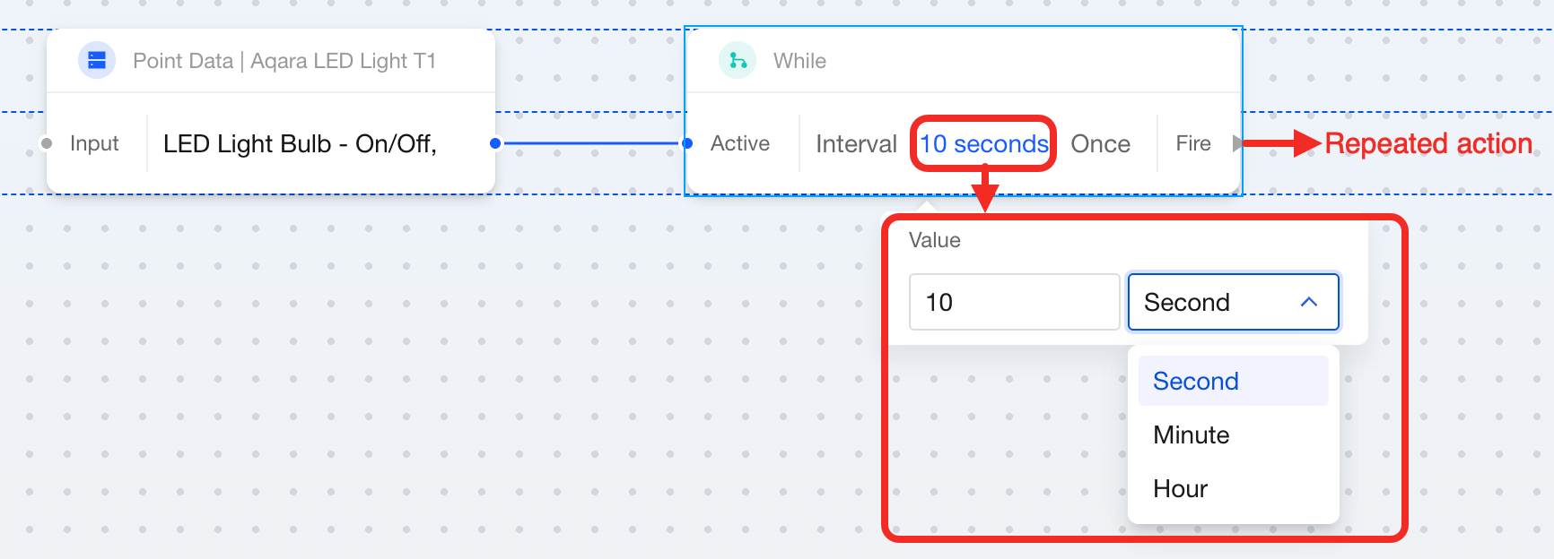

Single Boolean
Loop controlled by 1 boolean
When one boolean controls the loop:
  1. On the left, connect a boolean Point Data block (for example, the on/off state of an Aqara LED Light T1). The device's real-time state will be passed to the While block to start or stop the loop.
  2. Set the interval, i.e., the time between each execution (seconds, minutes, or hours).
  3. On the right, connect the action to repeat.

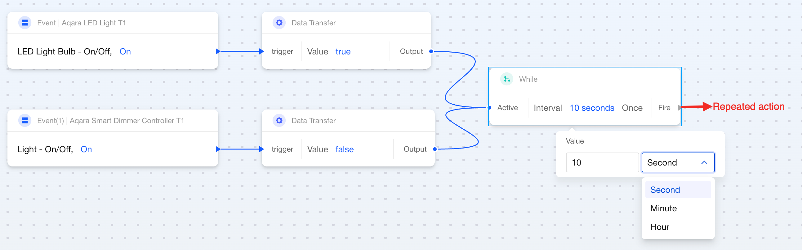

Two Seperate Events
Loop control by 2 booleans
When two seperate events control the loop:
  1. Add two different When blocks and connect both of their outputs to the While block's input. You will see a Data Transfer block appear between the When and While blocks. This lets you convert an event or state to a boolean and pass it to the While block.
  2. Specify which When block should convert to true (start the loop) and which should convert to false (stop the loop).
  3. Set the interval (seconds, minutes, or hours).
  4. On the right, connect the action to repeat.

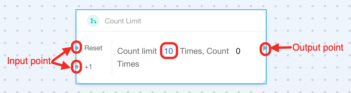

This is multiple-point block, with 2 input points*, 1 output point and 1 parameter:
connection point or parameterRequiredDescription

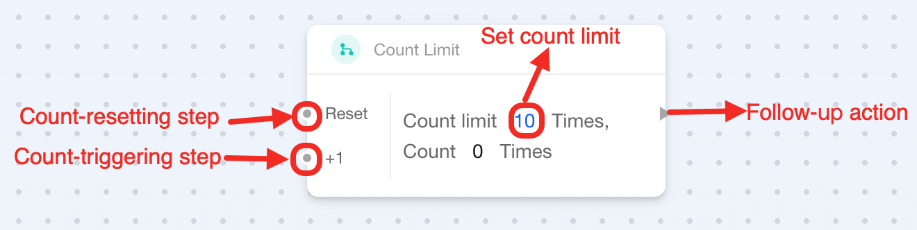

Reset (input)Resets the counter to zero when the connected step occurs.
+1 (input)Increments the counter by one when the connected step occurs and triggers the output step.
Count limitThe maximum number of times the target step can be triggered.
OutputConnect the target step to trigger.
How to Use
Count Limit
  1. Connect a step to the left-side +1 point. Each time it occurs, the counter increases and the target action is triggered.
  2. Connect a step to the left-side Reset input to clear the counter.
  3. Configure the maximum number of times the target action can be triggered.
  4. On the right-side Output, connect the target action. It will only be triggered by the +1 input up to the set limit.

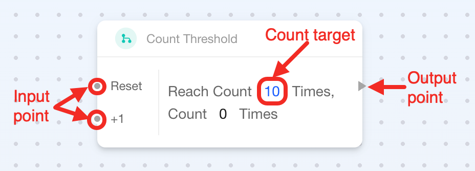

Count Threshold
Feature
Use this block to trigger a step only after another step has occurred a specified number of times, reducing false triggers.
Components
Count Threshold block components

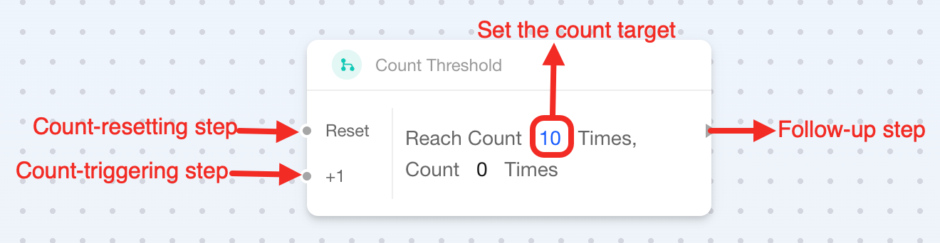

This is a multi-point block with two inputs, one output, and one parameter:
Reset (input)It resets the counter to zero when the connected step occurs.
+1 (input)It starts or increments the count when the connected step occurs.
Count targetThe count target; when reached, the target step will be triggered.
How to Use
Trigger after specified count
Here's how to set up a Count Threshold block:
  1. Connect the step to count to the left-side +1 point, and the step to reset the count to the Reset point.
  2. Set the count target inside the block.
  3. Connect the target action you want to trigger after the threshold is reached on the right-side output point.
  4. When the cumulative occurrences on the +1 input reach the target, the target step is triggered automatically.

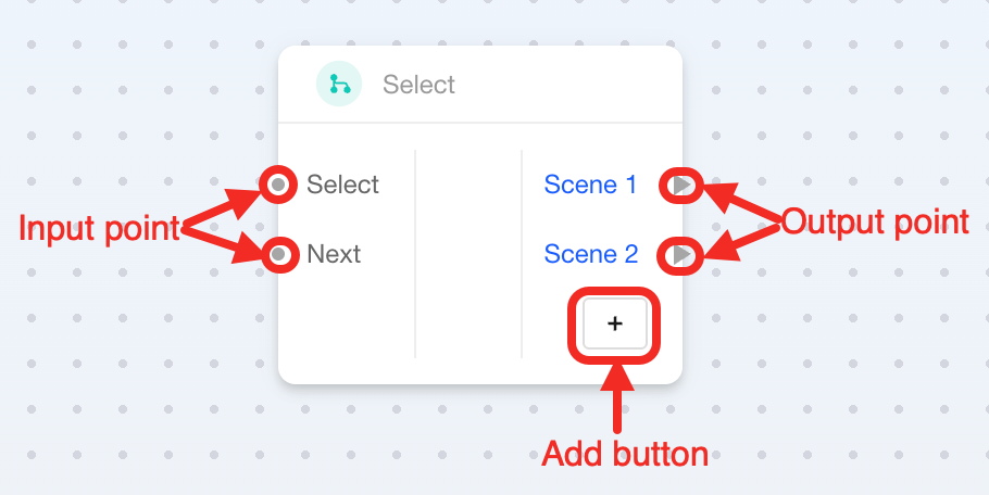

Select
Feature
Use this block when you want a device to perform different actions under different scenes/modes.
Components
Select block components
This is multiple-point block, with 2 input points, 2 output points and 1 add button:
Select (input)Choose one of theseWhen connected to a numeric block, you can select the scene based on the number.
Next (input)It connects an Event block. When that Event block occurs, it switches to the next scene.
Scene 1 (output)It connects Action blocks.
Scene 2 (output)It connects Action blocks.
Add buttonIt can add more scenes to connect more actions.

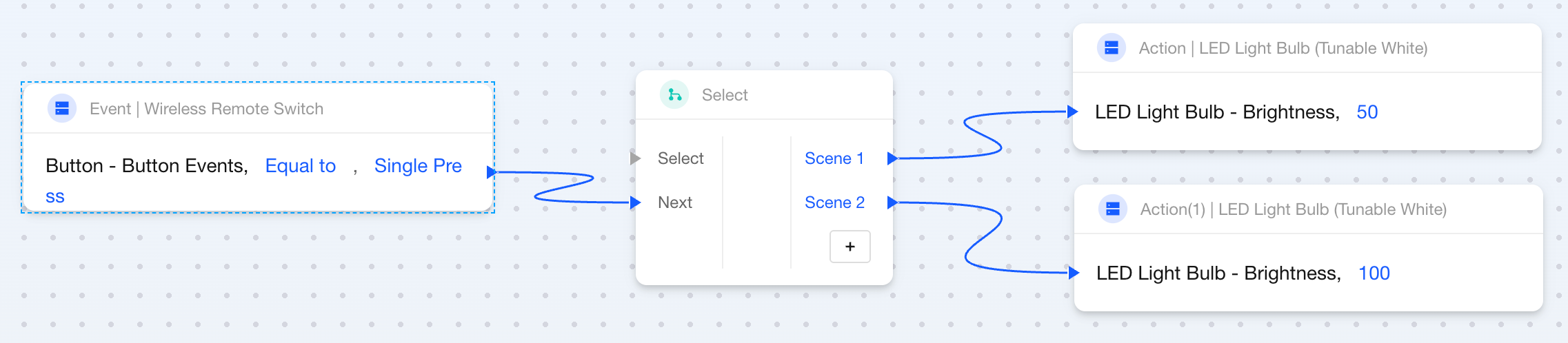

How to Use
Select steps
Here's how to set up a Select block by using the Next:
  1. On the left-side Next input of the Select block, connect an Event block.
  2. On the right-side Scene 1 and Scene 2 outputs, connect different Actions blocks for different actions.
