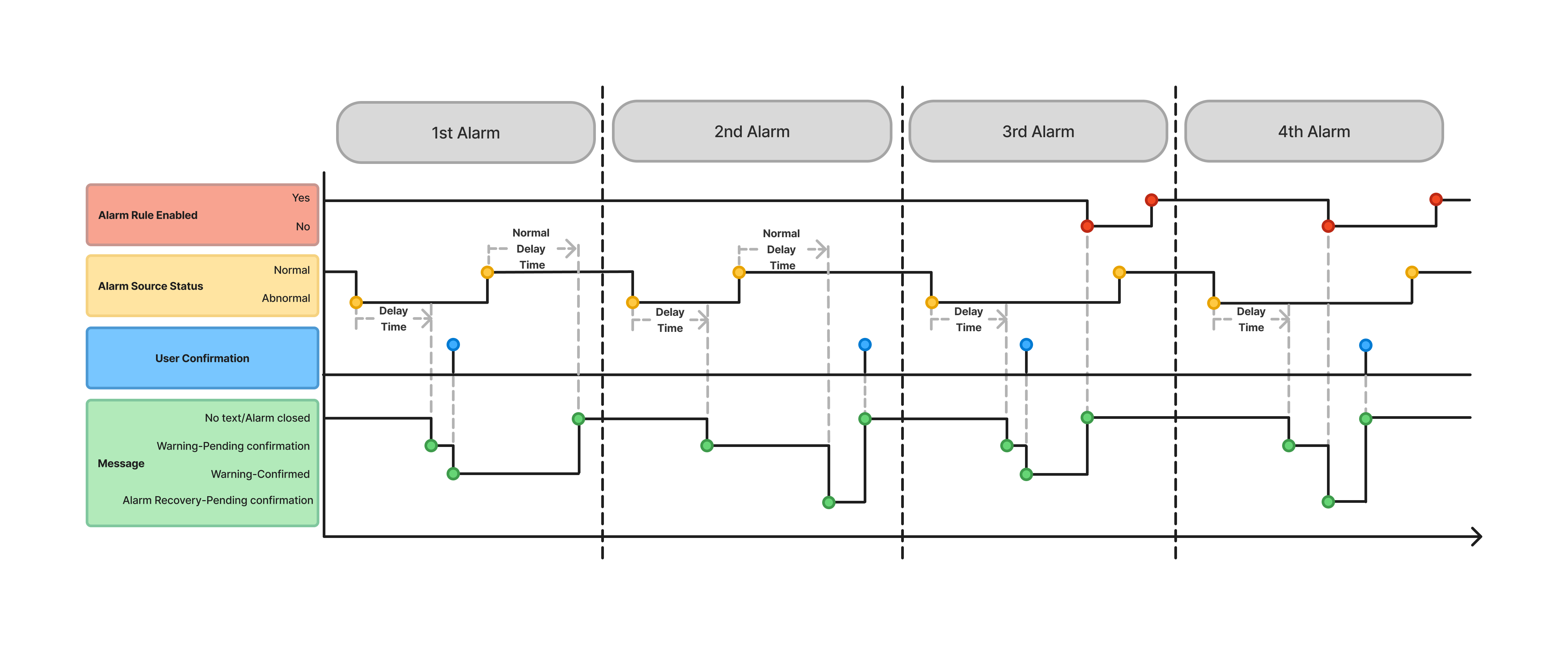

    The diagram below illustrates the effect of delay time, normal delay time, user confirmation of alarms, and the status of alarm rule activation on the overall alarm timeline:
    Alarm State Timeline

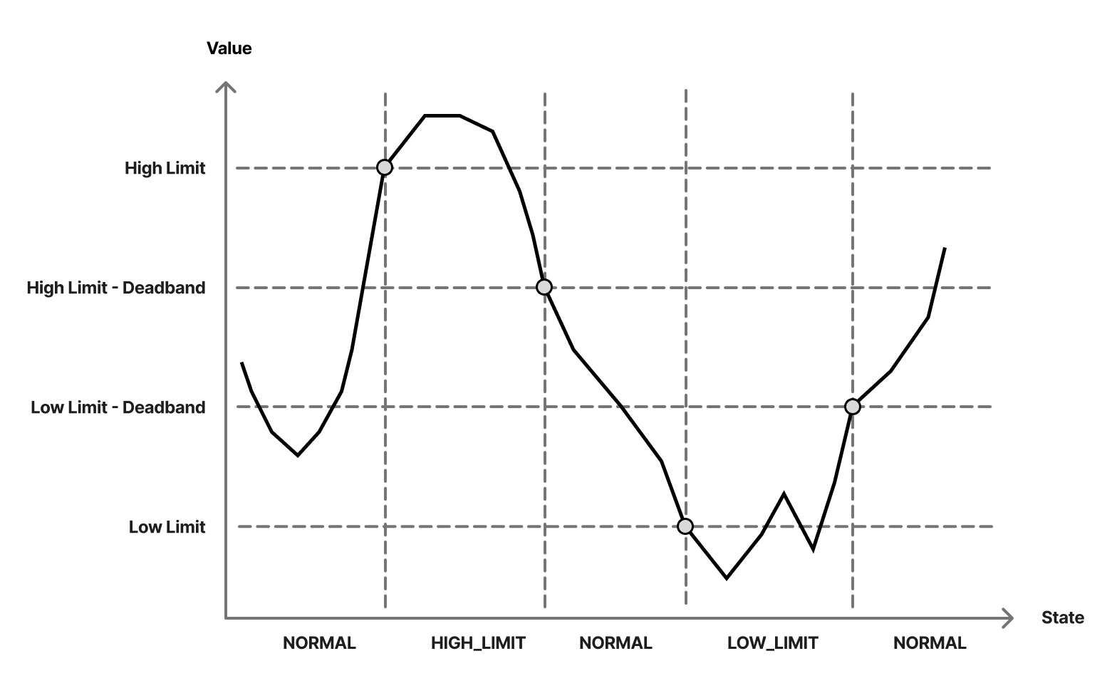

    DeadbandIt is used to prevent frequent state switching due to small fluctuations near the threshold.
    • When the low limit is enabled: Once the reading drops to the low limit and becomes abnormal, the state will only return to normal when the reading rises above the lower limit plus the deadband.
    • When the high limit is enabled: Once the reading rises to the high limit and becomes abnormal, the state will only return to normal when the reading drops below the high limit minus the deadband.
    The diagram below shows how the alarm state responds as the device reading crosses the low and high limits, as well as when it returns to the recovery points (low limit + deadban, and high limit - deadband).
    Alarm status for numeric readings
